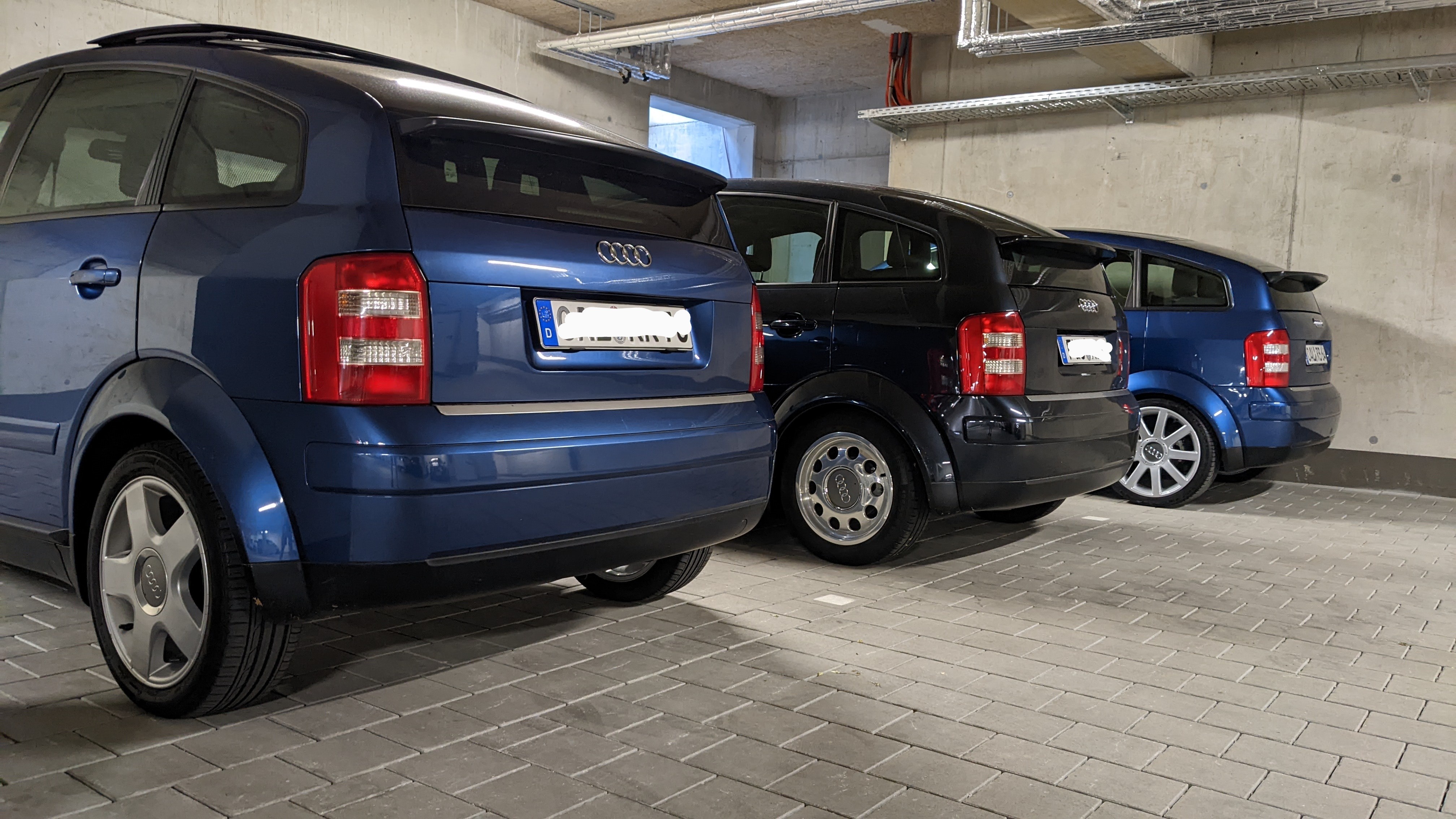

Currently I own three Audi A2's.
A few key data:
1.6 Fsi Mauritius Blue - weekend car
Owned since 2011
- 162.000 km
- 288mm brake
- Polo front axle
- KW V1 coilover suspension
- H&R Anti Roll Bar kit
- Audi Trailer Hitch
- heated seats
- Parkdistancecontrol
1.4 BBY cobalt blue - daily
Owned since 2012
- 300.000 km
- Disc brake rear axle
- Forged rims (polished)
- ST coilover suspension
- wood applications
- heated seats
1.4 BHC Mauritius Blue - girlfiends daily
Owned since 06/2022
- 183.000 km
- OSS
- 5 seater
- heated seats
- Webasto parking heater
- GDW Trailer Hitch
- handsfree

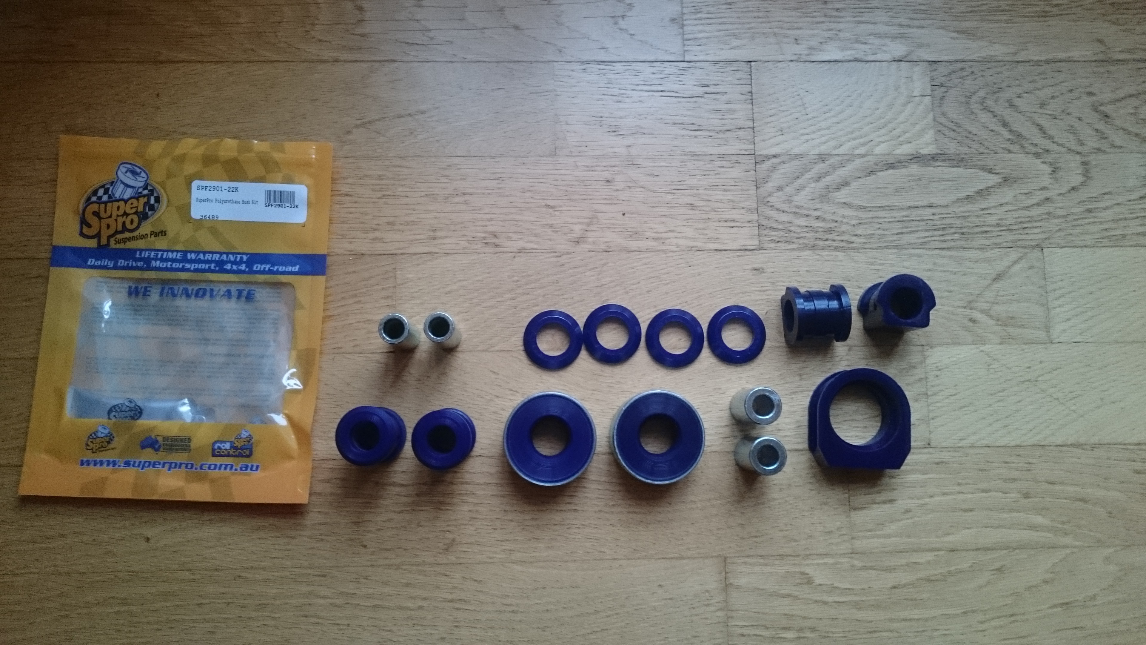

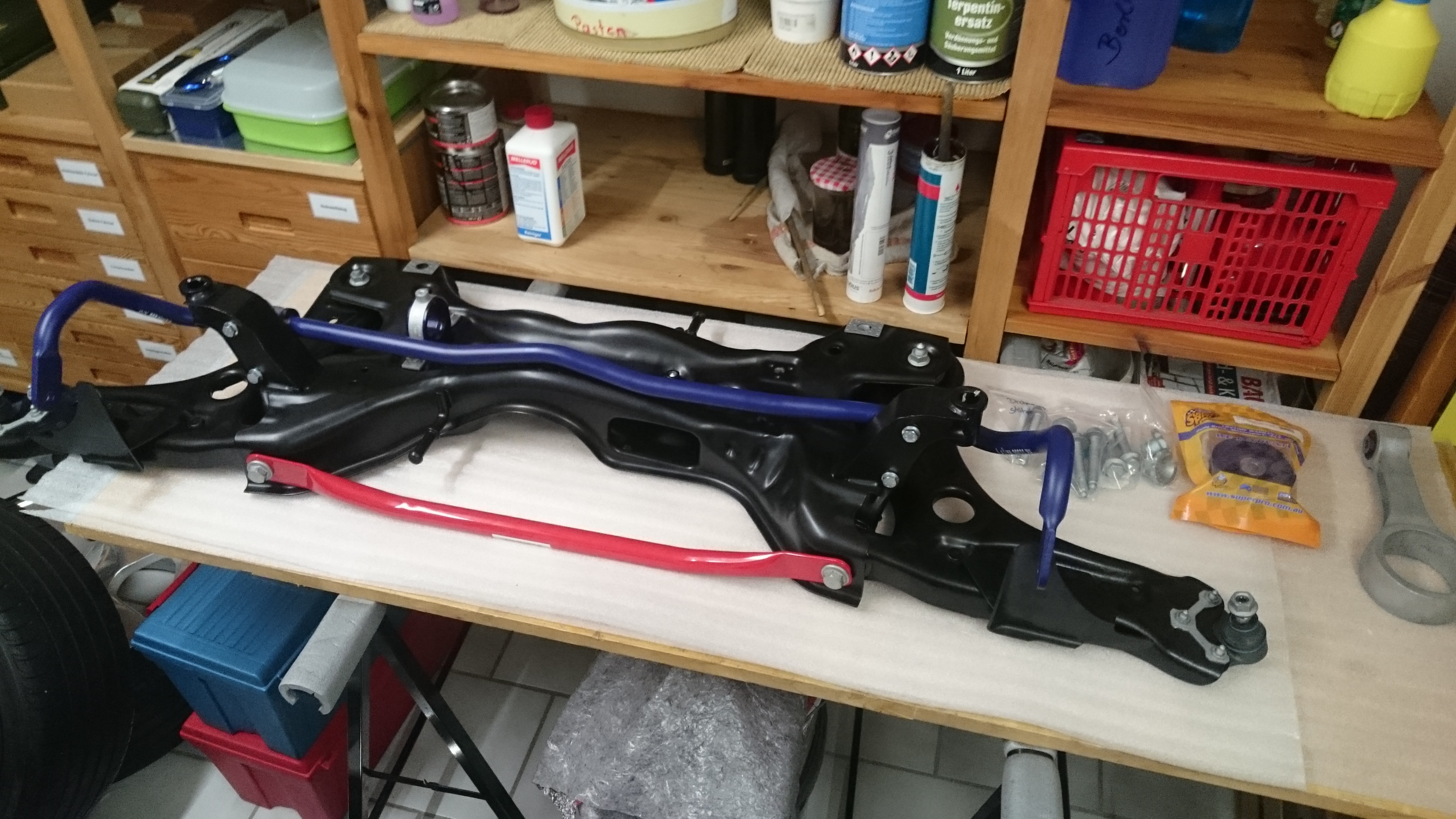

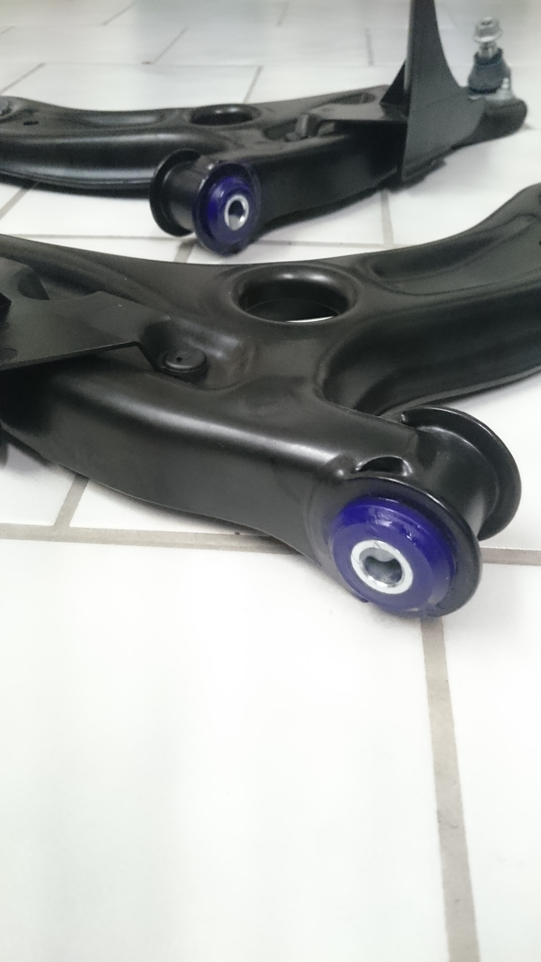

The front axle comes from a Polo 6r.
The advantage of this axle is both bushings are available as PU bushings
Also, Wiechers offers a suspension bar for this front axle.
This makes the axle stiffer It is important to note that you use the suspension joints from the A2 again, otherwise the track is increased by 10mm.
