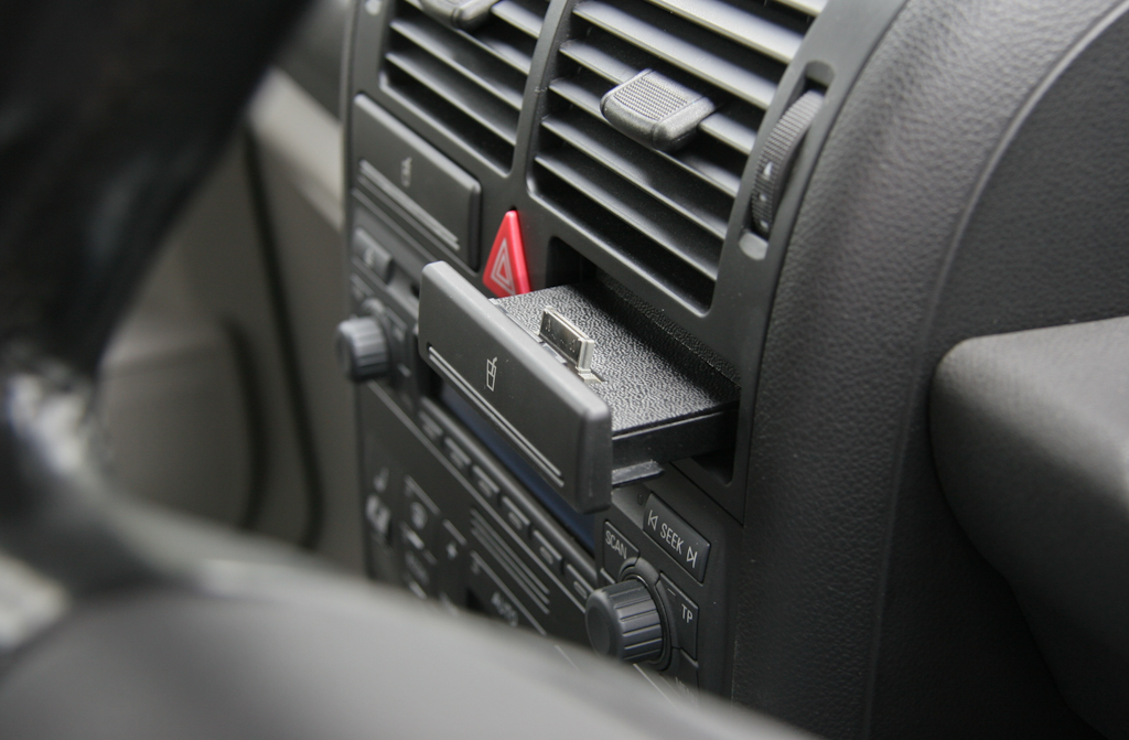

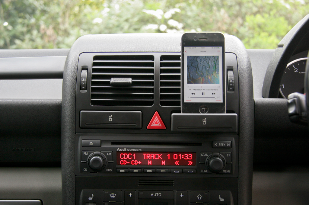

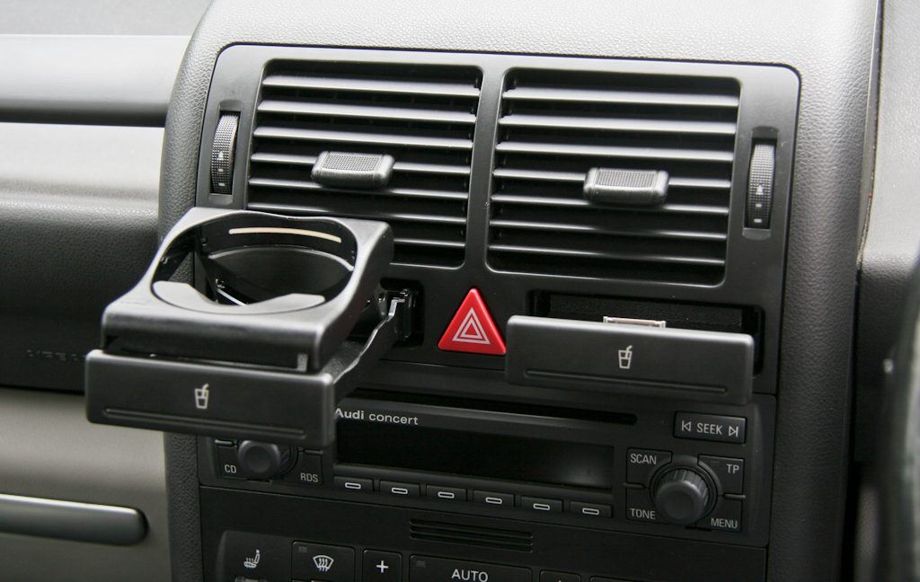

I also like to keep everything looking original. As Jelle says, the original radio just looks perfect in the dashboard. However, having your iPhone on display is also very useful for music, calls, SatNav, etc.
My solution was to convert the driver's cup holder into a pop-out iPhone dock.
The dock doesn't pop out as far as the original cup holder. It provides just enough space for the phone.
Of course, when you don't want to use your phone, the dock closes just like the original cup holder, meaning everything looks exactly like it did from new.
I still have an iPhone 4S, meaning I use the old 30-pin iPhone connector. However, when I upgrade my phone, I will make another dock like this with the new Lightning connector.
The audio connection to the stereo is over Bluetooth, meaning the dock is for display and charging only. Music streaming and hands-free phone calls still work even if the phone is not on the dock.

Honestly, it works absolutely perfectly. I have had this setup for about 4 years, and the iPhone sits solid. You can go around the roundabout as fast as you like, and it will not move. :)
